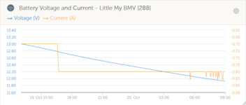

This is the kind of voltage drop you could expect from a new 100Ah Lead Acid battery with a very small load over 20 hours.

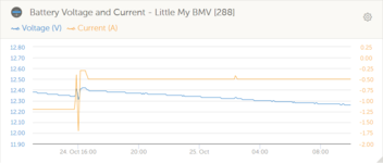

This is the same timescale with a not that much different load for a Varta 75Ah Battery that is knackered (bear in mind different scales)
