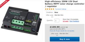

Your starter batt will be cream crackered, this is the correct solar regulator to charge all batteries if all of same type, other wise a split sys is required, two control reg units set to different types of battery

Agree with Trevskoda about Votronic to keep starter topped up if solar available.
