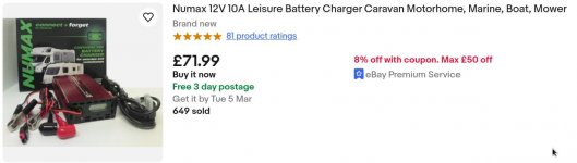

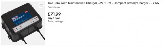

Smart charger is best, you will also require a link wire and switch to les bats to starter bat to keep them all up, lots cheap on ebay.smart ch.jpgnewmax.jpgmantanence chrager.jpg
I have used Clives method on a couple of vans quite elegant in its simplicity.
