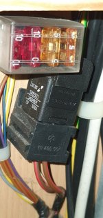

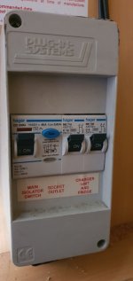

They are the only fuses in the motorhome apart from the fusebox I fit myself.

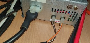

First pic is charger, black wire is the three core 230v EHU . The two on the right are leisure battery +/-.
Very simple to wire in new smart charger in its place.
