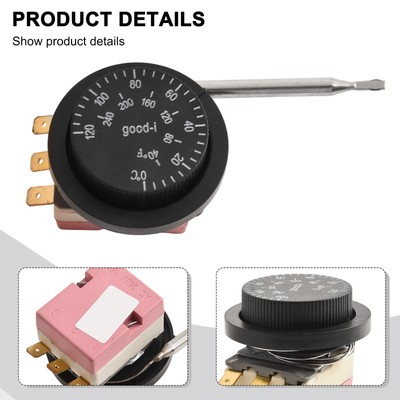

This means that your fan is being powered via the bulb (in series) but when the light comes on you get nothing because your connection is now grounded. If your fridge has an interior light then there's a 12v supply available at the rear of the fridge somewhere, you just need to do a bit of digging around to locate it. If not then You need to pick up a permanent 12v supply and neg and wire the fan back to there with it's own switch or you can use something like this so the fan only comes on when the temp gets high in the rear fridge compartment.
