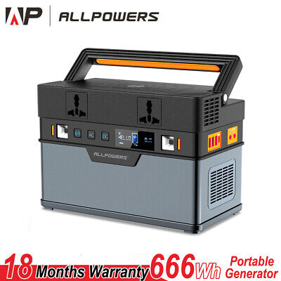

A battery in a box but I am having trouble reconciling their
Battery Capacity: 666.6Wh/186200mAh”
These look like very different capacities to me and neither seems likely in a 5.3kg package, even allowing for lithium. Can someone put my mathematics right?
The nominal voltage of a Lithium ion cell is 3.58V.
The battery unit is supposedly rated at 186200 mAH, which is equivalent to 186.2 AH.
So to get the battery capacity in WH, multiply the cell voltage by capacity in AH.
I.e. 3.58V X 186.2AH = 666WH
I hope this helps.
(And please note that I'm certainly not endorsing this product, just trying to clarify the physics).
Colin 🙂🙂🙂
Assuming the battery is 12volts, the normal conversion formula is (Wh)/(V) =(Ah) so, 666wh converts to 55.5ah.
Which answers my question of "how long will this run a typical 240v item" and at 55ah, not very long!!
I have always had an issue with the description of these items and sellers calling them generators. If anything, its the solar panel they're recommending you need to charge it that is the generator and this unit is purely a power storage unit.
Assuming it was advertised correctly, it's not a bad price, but how useful is a 500w 240v power supply that will probably only work for about 30 minutes, I'm not sure.
