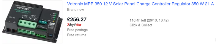

A smart mppt regulator will run through a multi-stage charge cycle and float.votronic 350.png
