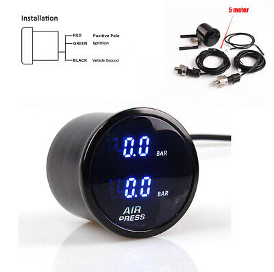

Don't know what vehicle you have BUT would a single 52mm gauge be easier?
Not seen the double gauge before. Looks neat.
Wouldn't be that much easier to find room probably, but I already have the gauges so wouldn't want to spend on more really, but a nice idea :)
They also do a quad gauge (designed for cars running air suspension all round)
