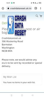

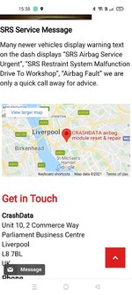

Crash data are closed, Peugeot can not give a date on a new one.
Any info on another repair company..
