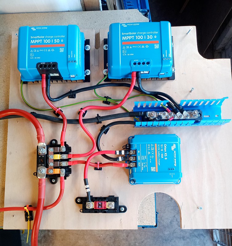

What is this "B2B or Solar?" question? either/or? Nah, need both ;) Just finished this sled for a camper build :)
Sled by David, on Flickr

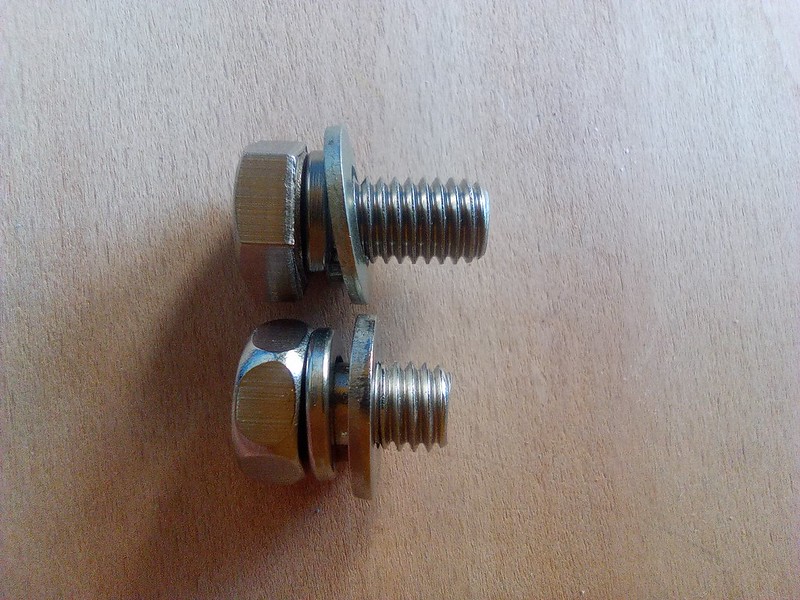

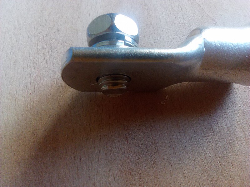

Just a comment on the Fogstar 460Ah battery .... I was rather underwhelmed by the supplied bolts with the battery.
Fogstar 2 by David, on Flickr
Very short and very few threads to secure onto the battery as they are so short! this photo shows what is left when using a 70mm2 cable lug.
This photo shows the supplied bolts with the Fogstar (bottom) compared with bolts I normally see on batteries (top).
Fogstar 1 by David, on Flickr
If this battery is being used as a swap for an existing battery, the chances are there are a stack of connectors on the positive terminal (last swapout I did had 11 connectors on the battery +ve terminals!). Have to do a lot of recabling with those bolts!
