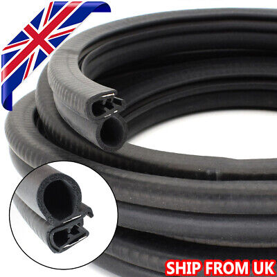

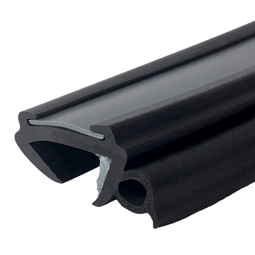

Rather than bending/twisting the door with the associated risks is it not worth looking at the seal on the doorframe and seeing if you can get a different profile to close the gap. Typical front door surround on something like an old 4x4 Mitsubishi Pajero is what I have in mind, available from a scrappy near you..
Something like
K ;)
Following on from Vanterrier's suggestion, these people have a wide range of seals. I have used them a couple of times. In my last van, after a bit of measuring, I managed to find an 'oversize' seal to fit the hab door extrusion and fill a gap at the bottom.
Well sort of. Been a bit on the busy side with other stuff but did get the thing close to the frame using the Mk1 mallet technique and stuck some self adhesive door seal on the casing. I will have a gander at larger door seals though, when it warms up a bit (soft git).
