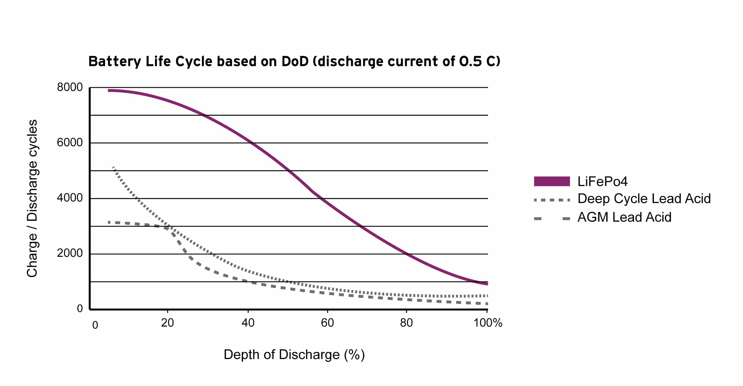

But ALL batteries - INCLUDING Lithium - suffer like this to a more or lesser degree ... the more that is taken out the battery, the less overall cycles it will deliver in its service life. An example graph is below. But because Lithium starts off so much higher, many manufactuers will quote a life cycle based on a higher DoD as the number still looks so much better then Lead Acid which allows them to declare a high DoD as well.
