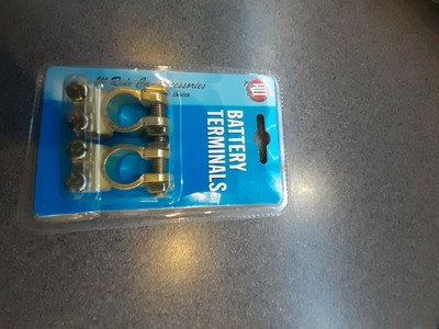

You can easily replace with one of these
The garage who supplied the initial battery took it out, charged it and refitted it before it failed so I'm clear the initial battery was at fault. But thanks for the advice re replacement terminals. Appreciated.
