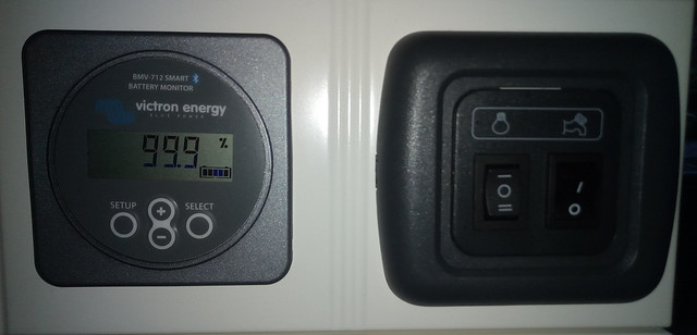

The way I did this was to use the Relay output on the Victron BMV-712 Monitor to control a power relay that switches the electric supply to the Water Heater on and off based on the Battery SOC value.

I do have the BMV-712 Monitor and know about the power relay thanks but not sure how to get it to power the heating element
ok. what you could do is this ...
(this is based on the inverters sole job is to provide power to the water heater)
Replace the on-off switch on the controller with an on-off-on switch
move the existing wires from the 'on' and centre connections on the contoller to the centre and one of the 'on' connections
connect the other 'on' connections to the BMV relays "NC" terminal (and connect the BMV Relays "COM" to 12V)
Program the Relay with the SOC parameters - set it to say 99% and 90%.
Then if you want the heater on manually, switch to the manual ON; and if you want it on when the battery is full, switch to the other ON.
You could do the same thing away from the inverter by fitting an on-off-on switch to control an 240V SSR (Solid State Relay) via the BMV and have that in line with the AC cable to the heater. This is the way I did it on my last self-build camper.
I used the CBE switch for lights and water pump, but used the left 'lights' side for the water heater, swapping out the normal switch for a 3-way on-off-on one as you see from the photo below.

Thanks I look in to that
Sorry it’s a Alde wet heating and not a truma system
don't think it matters - you want to just control the power availability. (mine was not a alde or a truma, it was an Ariston 240V heater, but that is by the bye).
