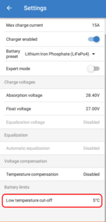

Over the last few weeks our van and its solar panel has been sitting in the garden sucking up all the sunshine it can and squirting it into the two ( Victron LFD90) 90ah batteries.
A couple of days ago, I checked the batteries via the Victron Ap and the batteries were full, the app showed that they were in the float setting.
Today, I checked the app and, despite it being sunny, ( and the solar panel in the sun) there was no charge going into the batteries. Battery temperature was 8 degrees and the voltage was 12.52v.
The app shows there has been no charge going into the batteries for 2 days.
The app has various battery presets, and for the last 2 years, it has been operating correctly with the Victron preset. It will only work now if I use the factory default preset ( which is for AGM/gel batteries)
Any ideas why this should happen? Is my controller on the way out?
I contacted Victron but they had no idea!
