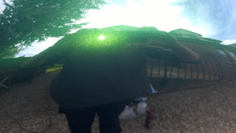

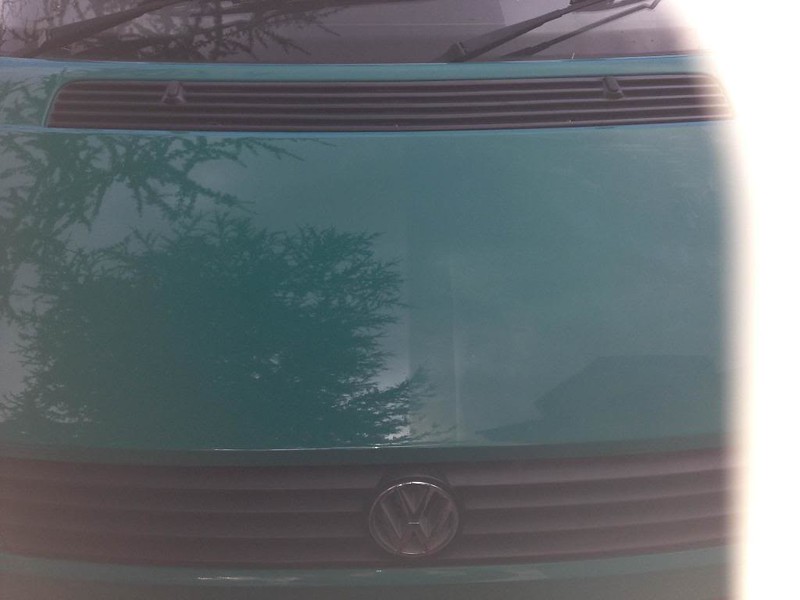

The classic 50:50 shot ....
50:50 Bonnet
by David, on Flickr
But remember, all polishing of paintwork is achieved by removing the top surface of paint (or clearcoat) and if it is done too much or too often (or there is not enough to start with) you end up with nothing!

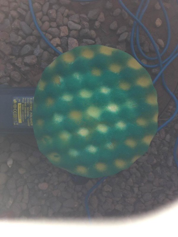

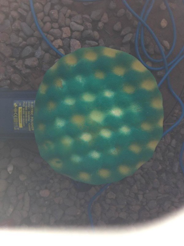

Pad after the partial bonnet polish ....
Pad after Polish
by David, on Flickr

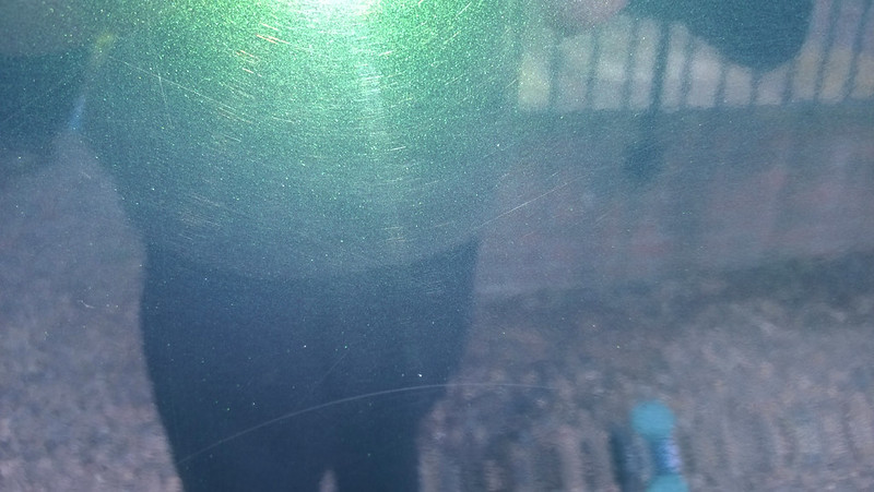

My Toyota RAV4 when I bought it at 10 years old. Paintwork was good but very swirly.
Swirls by David, on Flickr
Some work with a MOP and 3M Perfect-it kit
Polished by David, on Flickr
The swirls are still there, just a lot smaller.
In my picture? no, that is the metal flake in the paint.
I can't tell of course from a picture David, but all compounds and polishes if applied by machine by their very nature leave scratches it's just that they become less visible with finer and finer polishes.
I do like that met green though, lovely colour.
yup, that is right - and by hand same as machine - and eventually they get too fine to see as you go up in grade.

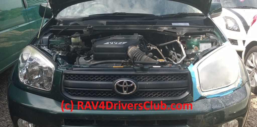

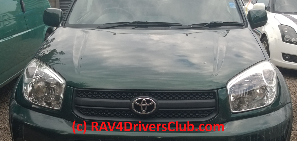

Same car whilst I was renovating the headlamps .... The right and left ones looked the same before I started on the passenger side one :)
This was sanding the lens with 500 grit.
666Head-S1_Post_500-3
by David, on Flickr
Went through 500-1000-2000-4000, then onto the Plastic Restorer and Plastic Polisher
666Head-S6_Headlights_Renovated
by David, on Flickr
(I didn't really need to start at the 500 as not that bad but wanted a full series to post on my Forum to show even really bad ones can be fixed as long as they are not physically cracked).
