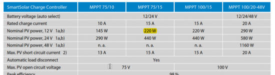

Can I wire another 100 watt panel to the 75/15 Victron charger or is it overloading it.?
I am considering buying a Renolgy portable suitcase 100 watt panel to assist my 120 mono on the roof of our MH.
The 75/15 can handle 220W at 12V so yes you should be okay (y)

and to add to that, if you do "overpanel", the worst that will happen is any output over the rated maximum current (so over 15A in the case of the 75/15) will just be capped at that maximum and no harm will be done.
