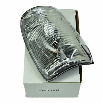

Hi, somehow (probably a Branch), managed to break the passenger side Wing Mirror Lens Cap, does anyone know if and where I can buy just the cap and not the whole new Wing Mirror? the next question would be how to replace it but this may be irrelevant

Is that a transit if so you can replace just the indicator you can pick them up on eBay for about 15 20 pounds. Pop the glass off the mirror by tilting glass to side and pulling off all the screws and fixings are behind the mirror glass. Think the fiats and others are basically the same.

forget that, I think it's a MK 8 so will give that a bash - thanks once again

I would tend to agree, because I don't think that the earlier Transits had a wing mirror indicator repeater. It can be a bit difficult using Mark numbers, because some sources use conflicting numbering systems. For example, Parkers Guide calls the latest Transit the Mk5! Best to use build year as a guide.
