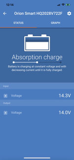

I thought the van had a smart alternator and this was why it wasn’t triggering my VSR but came to realise that it wasn’t smart at all it was just duff! The output voltage rarely got above about 12.6V
We fitted a new alternator this morning and it appears to be working fine. The output voltage is 14.3V as below.
I’ve also checked on the leisure battery monitor, loaded it up by turning on a few lights so that I could see that it was discharging at around 1.5A, sttarted the nine and it changed to charging at around 4.5A so the alternator is definitely delivering charge.
But...
After running for a few seconds the battery light comes on. If I restart the engine, it stay off again for a wee while but then comes back on. All the while my OrionSmart charger shows to be charging with the correct voltages.
Any thoughts/suggestions.
