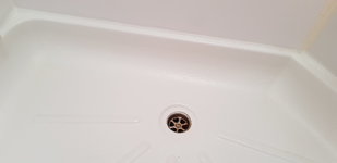

Photos of the shower tray cracks. Now need to decide which method to use.
