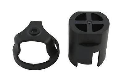

There is a special tool required to dismantle it, it must be done in a vice in a workbench or it won’t seal correctly and sometimes the upper seal ring will split and leak. Always a while after having been ‘serviced’ and not whilst being serviced.

My advice, use the service tool, smear silicone grease on threads, apply smear of fuel resistant sealant (Hermatite/hylomar) to seal and torque to 35Nm.

Here’s an example of the tool to get, cheap enough. I replace the filter using the tool and always carry a spare.
