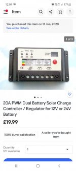

Mine was a mppt for 60 quid I'd you need details
I have had one of these for two years or so now and it seems to do the job. As David said, you will probably find a point near the onboard charger where you can have easy access to +ve connections for both batteries. This how mine is fitted because I never required the ''start assist'' that can be done to get a bit of a kick from the leisure batteries if need be. Just a 20A fuse in each of the +ve connections on mine for a bit of protection.
