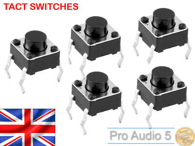

When my step didn't retract using the buttons I had to replace the Akai MPC Tact Switches on the step switch
