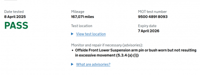

Still going strong, I jsut checked the history and it's only failed on minor stuff like lights.
