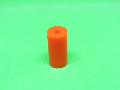

There is a flow restrictor you can install that thetford provide with their toilets - its like a round bung with a small hole in the middle that you install on the inlet pipe. If you are handy you may be able to DIY - depends on the install
Quick search on ebay

Ah - didn't see that. The pump is subermisble I believe (as I had to replace mine on my old van). You could take the pump out, and use the reducer in the pipe, or indeed other means to reduce flow? Or perhaps put something in the electrical side and reduce voltage to 9v from 12v which would reduce the power of the pump?
