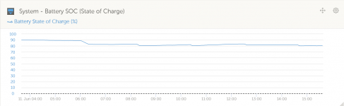

Off original topic, but if you have decent solar, using the Water Heater on electric via Inverter is very doable.
Each one of the dips below is the water heater coming on (the first bigger one is the initial heating, the others are top-ups). Only lost 10% of the battery (this is also powering the 240V Fridge BTW) and today has been very overcast. If I had solar I'd be back to 100% by now.

Looks very good, but am I to assume these are not Lead acid batteries? and does it have a deterioration effect with all the charge/discharge cycles?

That will have mostly used the Lithiums, but the Leads would be no different. With 100Ah and 85W of solar, not, it would not be doable (wild camping off-grid 100% with just 100Ah and 85W of solar is tricky enough to achieve!)
