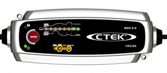

Flat as a fart even though it's been hooked up to a NEW Ctek charger.

A smart charger should be left on 24/7, it should hit 14.4v and drop back to a float of around 13.4 ish then go into a cycle mode, seems to me there is something wrong or a item sucking juice, try removing the earth and charge the battery unconnected.
