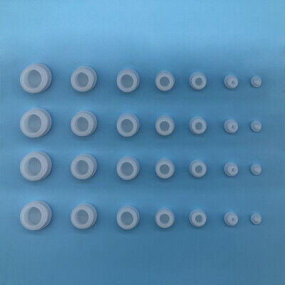

Plugs here...

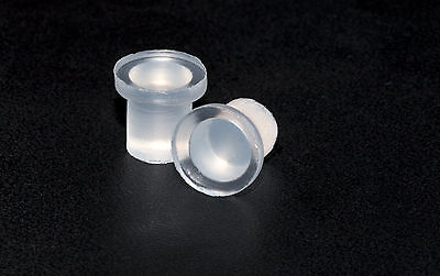

When you do want to fit the bungs, it's easiest with a small diameter rod (I found a suitable-sized plastic one) pushing on the part of the bung that has to pass through the small hole in the window.

I ordered some new bungs from LeisureSpares in the end so that I get the genuine Seitz spare parts - very expensive at over £12 for 6 but postage was a fiver of that.
