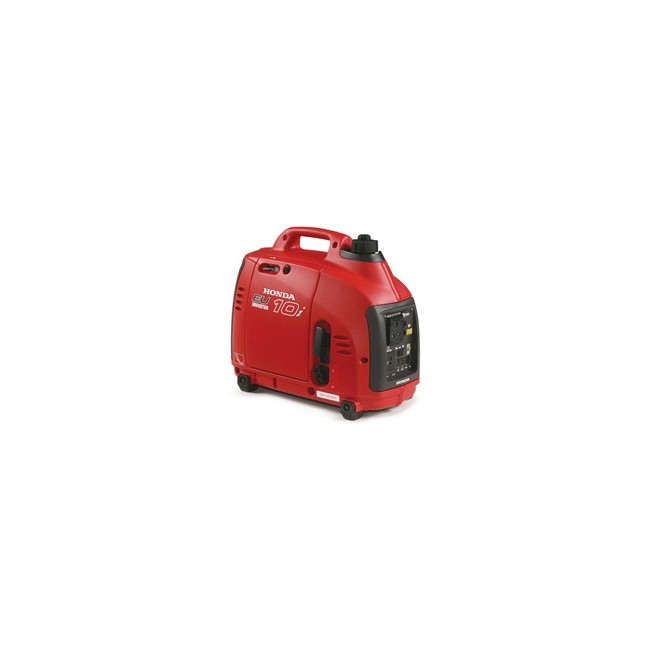

Got to be a Honda, I have 3. EU20i & 30i that are used on a shoot I’m a member of and a EU10i that lives in the motorhome.
Not cheap but you get what you pay for Imho. My EU10i is only used in the winter to top batteries up if and when needed and I have both the generator and petrol can stored in zipped carrybags from bags & covers direct which virtually eliminates any smell.
Also treat the petrol with Briggs & Stratton fuel fit to prevent the petrol going off for want of a better word, always start regardless of how long they have been stood.
