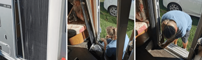

Has any body successfully recorded this screen. Our cords seem to have broken after 7 years and I’ve really no idea where to start.
Or is it necessary to replace with new🤔
Did mine on a Ducati sliding door, used 0.8 mm waxed cotton , found it very successful once I’d worked out the route by trial and errors, 9 hours from start to finish that included removing the whole frame and working out the spring adjusters as well, good luck my phone number is not available 😀😀
