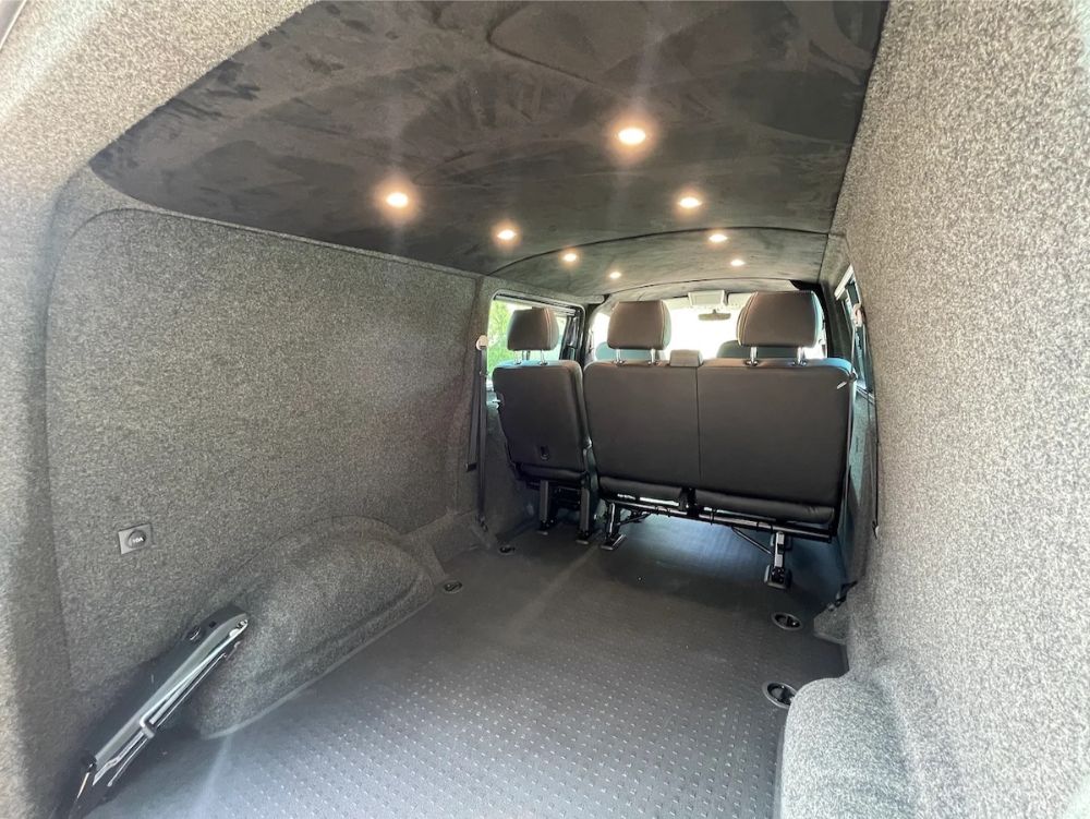

Or you could consider carpet lining;
As well as carpet lining they also do a sort of suede lining. From their website;
"In addition to our remarkable carpeting, we offer a luxurious suede lining available in a range of three captivating shades. Backed by a plush 3mm foam layer, it’s perfect for headliners that not only look stunning but also provide a delightful tactile experience."
Might be worth an inquiry?
