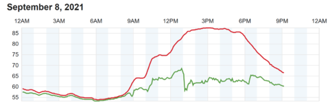

Today was the hottest day in Scotland for 116 years - measured around 13 miles from me as well and it did feel a little warm today.
This is a screenshot of the Weather Station in the garden (Temp in Fahrenheit) ....
I'm finding instead of the usual on/off cycle of around 25-33% on/ 75-66% off, the fridge compressor is staying on a lot longer, which I am not that surprised about.
But .... from what I understand it is a small price to pay, and a 3-way Absorption Fridge will just not be able to keep anything cold at the sort of temperatures we have got in the last couple of days? Is that correct? Or a bit of an exaggeration?

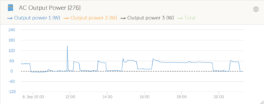

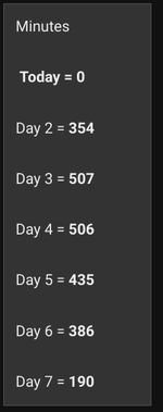

With 750 watts of solar I run it on AC and over the last few days the heating element has been powered for this number of minutes, the best day being 507 minutes. That is a saving on gas!
Comparing my power consumption with that of wildebus at the start of this post gives some idea to the inefficiencies of a 3-way unit!
I was pleased to see that even though the inverter requires ~20 Amps DC to power the fridge, the solar could still capture enough to be putting ~10 Amps into the batteries at the same time. I find it a little disappointing that the 750 Watts of solar peaked at 439 Watts.
