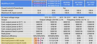

Don't forget inverta have drain of about 15 percent when turned on .
The Multiplus is nowhere near that.
If it is set for one of the standby modes (Search or AES), it will have an average 'drain' of between 3-9W, and if just left on and nothing using it, will have a 'drain' of 13W. I've pasted the data below and highlighted the relevant numbers in pink.
I have my Multiplus Inverter switched on 24/7 but it is actually actively "ON" maybe 25% of the time, when the Fridge requires power. The rest of the time it is in 'Search mode', where it will check for a load demand every couple of seconds and then go into standby again - or as Victron calls it, "Low Power" Mode.
