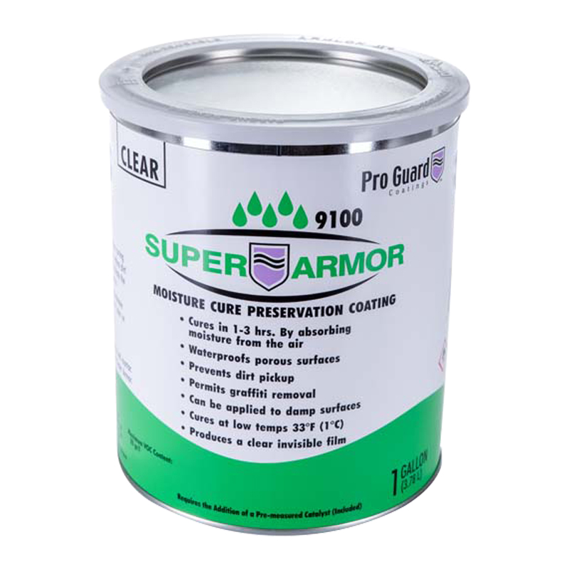

Having has a water problem I use a combination of Captain Tolley and
I "painted this" on the roof by and on the seams about 3inches wide.
And on the join between the hab roof and the cab roof
Our roof is similarly flat !
The product is clear and you can see it has been done (just) but it is out of sight.
