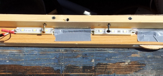

This is a mock up to see if it was worth doing so a bit of a bodge, but it worked really well in practice, Mine were much cheaper than the bay ones linked, and mean for use in signage, they were about a quid for each section, and I used those tiny round 12v switches.

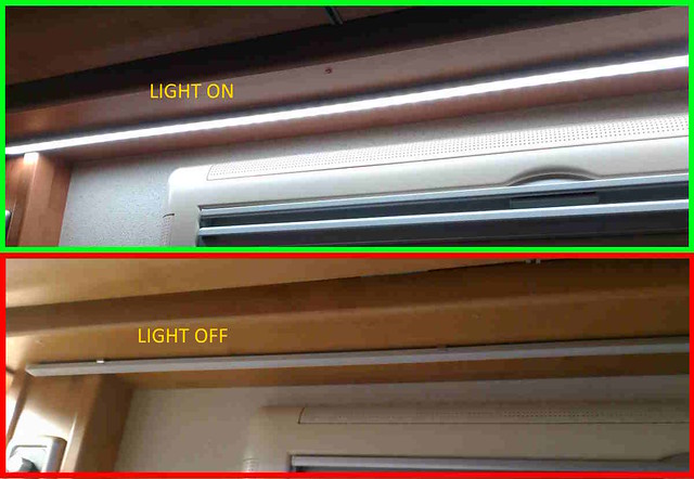

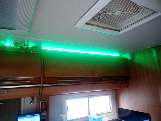

I added some mood lighting above the cupboards
Lights Off
MH Strip Lights
by David, on Flickr
Lights On
MH Strip Lights
by David, on Flickr

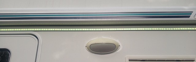

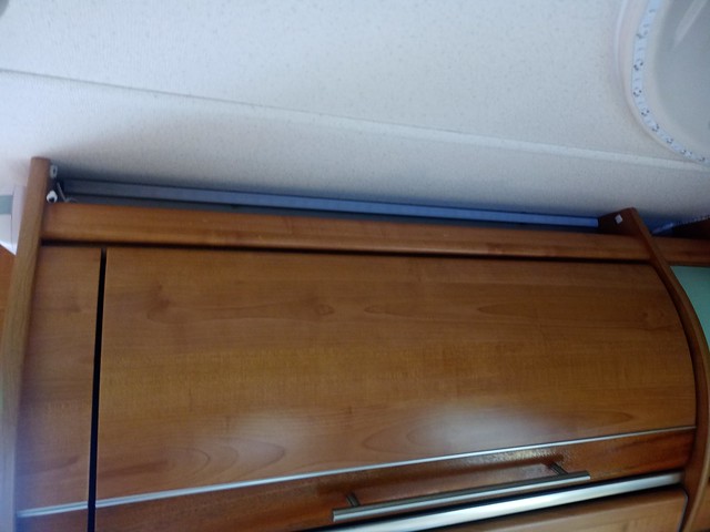

I like to use aluminium strips with diffusers to mount the strips on as it both looks nicer and is more secure. I prefer to use the COB LED strips rather than the usual LED Strips. The COB Strips emitters are much closer together and avoid that 'dotty' look.
Used same mounting on the outside for an multi-colour LED strip below the awning
Awning Strip
by David, on Flickr

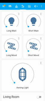

Mood Lights can control by a remote control, voice control by Alexa or a PC App
The White undercounter lights and the Awning lights are controlled by Alexa or a PC App.
My 3 main light units can be switched from soft to pure white light, front 3 cab swival lamps are soft, all can be controlled from my key fob as do the entrance door lamp and under step lamp, handy when arriving in the dark.
A bit of time wireing and sorting main lights but worth it.light 1.jpglight 2.jpglight 3.jpglight 4.jpglts b.jpgvs16.jpgs13.jpg
