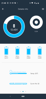

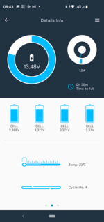

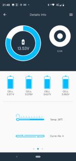

Bit off topic, but to finish my observation from last night and this may be of interest to the OP as he has the same battery I believe?
I find the cells are out of balance a bit after a significant load or charge. The BMS then internally does the cell balancing over a time (they can only transfer small currents so take time to even out).
These two did a recharge from 40% SOC this afternoon. By the morning, due to no load and only float charge levels, all the cells with be within a few 100ths/V of each other
So just after some extended charging (where, I believe, Cells within a Lithium Battery always are out of balance to a degree due to the fact that no cell is identical to another, even though the manufacturers try to match as closely as possible the various cells in each battery),
Battery 1 (4 cycles) has a range of 0.065V and Battery 2 (52 cycles) has a range of 0.08V between the highest and lowest values.
After the BMS has done its stuff while the batteries are under little load or charge the cells are pretty well matched up
Battery 1 (4 cycles) has a range of 0.003V and Battery 2 (52 cycles) has a range of 0.03V between the highest and lowest values.
The second battery is a little more unbalanced as it is currently more active in terms of charging, but will balance out more when it is more 'at rest' (even though these are in parallel, just like with Lead Batteries, there is a difference between them. It is only when you have individual cell or battery monitoring you actually see this. a standard battery monitoring setup like a BMV on a whole bank doesn't reveal this detail).

View attachment 61035View attachment 61036
