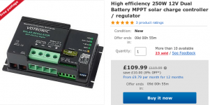

Sometimes lights etc, best ditch it and fit a mppt unit to charge less and starter batteries.solar duel a.png
