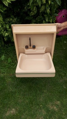

Question on ASOF wanting a Cleo tip up basin, same question on here (or Wild).
I do want a cleo tip up sink but I am not on ASOF as I don't have an AS...
K ;)
What a coincidence. The two posts asking appeared within 24 hours.
I actually have one but it has a rounded front edge whereas the Cleo is squarer. A used complete Cleo went on eBay only yesterday for £78. They do come up occasionally. This any good...
