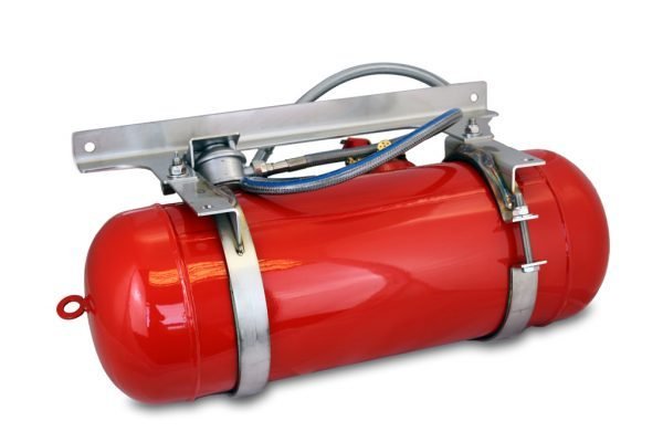

Can I mount two stage regulator upside down, using mounting plate to screw into chassis.
See picture.
I have see a few youtubers installed upside down and seems working, what is your thoughts on that?

I would have thought the regulator needed to be vertical with the inlet at the bottom to encourage residues and condensates to flow back to the tank. They can foul up the regulator if they flow the wrong way.

I think it's designed to be fitted undearneat slightly above Lpg tank and I have see factory build campervans and even fitted Lpg by propex used this particular regulator pic at 1st post in upside down manner.
Perhaps someone who is familiar with this regulator would clarify little more? Thanks

depends on orientation in this case i would take upside down to be flow arrow pointing up rather than fixing plate

Arrow just flow direction not upside down mark. Also there is small air ventilation hole on the top head. And someone said hence the top head should be facing upward not downward.
