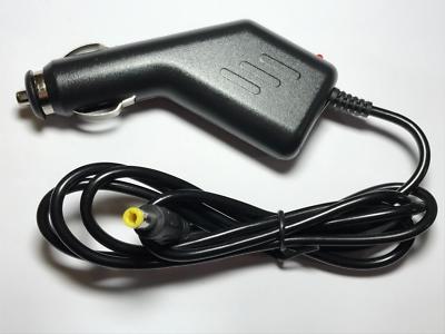

Why would you have to take a perfectly good power supply to bits with a pair of rubber g.oves on. It's output is 12v at 2A so all you need is some way of producing 12V at 2A. You certainly should not plug it straight into the vehicle electrics as they are not 12V. A simple voltage stabilizer with the correct plug will do it.
Something like this ..
