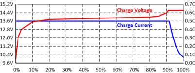

The graph below shows a typical profile of a LiFePO4 battery getting charged. To make it easier to read the Voltages have been converted to what a 12 Volt LFP battery pack would see (4x the single-cell Voltage).
LiFePO4 Charge Voltage vs. SOC
Shown in the graph is a charge rate of 0.5C, or half of the Ah capacity, in other words for a 100Ah battery this would be a charge rate of 50 Amp. The charge Voltage (in red) will not really change much for higher or lower charge rates (in blue), LFP batteries have a very flat Voltage curve.
Lithium-ion batteries are charged in two stages: First the current is kept constant, or with solar PV that generally means that we try and send as much current into the batteries as available from the sun. The Voltage will slowly rise during this time, until it reaches the ‘absorb’ Voltage, 14.6V in the graph above. Once absorb is reached the battery is about 90% full, and to fill it the rest of the way the Voltage is kept constant while the current slowly tapers off. Once the current drops to around 5% – 10% of the Ah rating of the battery it is at 100% State-Of-Charge.

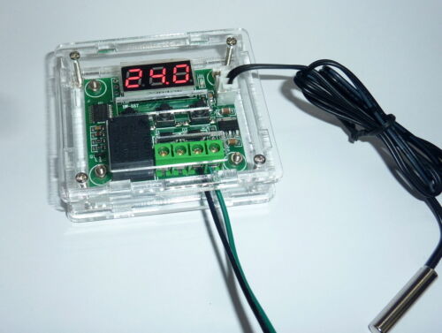

Just a thought , could something like this be connected to the charger output ? , this one is 20A output but I think it will have to be a lot more . Thanks
