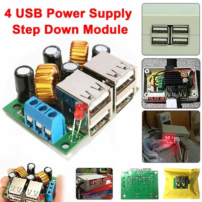

I've used a number of these in our van.
4 USB sockets and a wired output too. I have 3D printed a support and fitted the in CBE outlets.

Interesting Chinglish in the description but looks good :) Presuming it needs a double CBE to fit the side part in as well?

Yes, it takes 12v in, I have added an additional fused busbar which is connected to the battery so effectively permanently.
The wired output is used to supply a RPi, the USB feed its SSD.
Another one feeds an additional SSD used to store media played from the router.
Another one is used for phone and Chromebook charging.
The readily available CBE style 1.5/2.5 USB sockets often failed to charge phones fully due to low voltage from battery while wild camping. These have cured that.

This was the first one I made, later ones look better.
