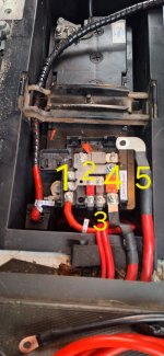

This is my starter battery and I've numbered the cables. It may be useful for fault finding.
#1 dc to dc cable
#2 - Electric windows
#3 - Wipers, side lights, dipped headlights, mirror heater, Indicators and courtesy lights.
#4 - Full beam, blowers, brake lights and reverse
#5 - alternator and starter motor
#1 dc to dc cable
