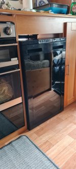

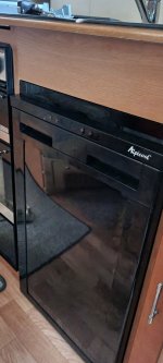

Further to my previous posts I have finally fitted the replacement fridge. I thought I would share the details in case someone else needed the same swop.
The Dometic fridge aperture is 821mm high but I had the sink bowel waste reducing this to 785mm in the middle of the carcass.

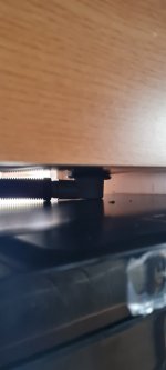

The Alpicool was the correct width but 790mm high, replacing the tall rubber feet with a shorter type brought the height down to slide in. It's left a small gap at the top of about 35mm that I plan to infill with something later.
