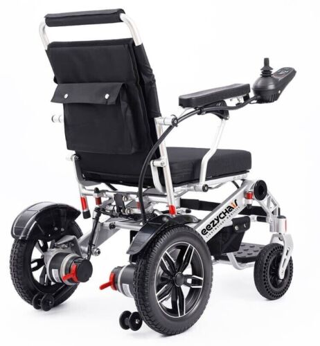

Having sold the mobility scooter, I'm thinking of buying this, I saw a old chap up in Scotland with one and he said it was a brilliant bit of kit and not too pricey so, I had a bit of back and forth with the company and I'm on the point of jumping in, I can use Paypal and do it over three months which fits fine with my meagre finances.
But, I still have the same issues of charging but this does come with two batteries, but only needs one to rum max miles on the 10ah one is 12 miles so the other could be in the van on charge now and then.
The inverter is the same as before a 300w and is now hard wired to the leisure battery I didn't like having it in the ciggy socket much.
But!! it comes with a 24V 2Amp charger, so is there a ciggy socket charger 4a or more that will charge a 10ah and a 13ah 24v battery, I have looked but may have not put in the right form of words to get a result.

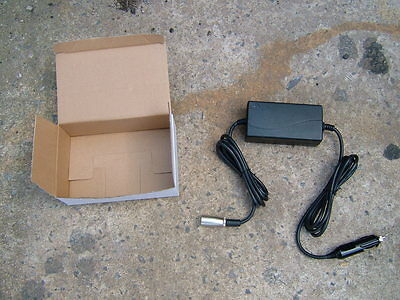

Try mobility scooter car charger in your search Kev. Lots about just need to make sure the plug is right one
I bought mine from a mobility shop via ebay for less than £30 brand new but was a few years back

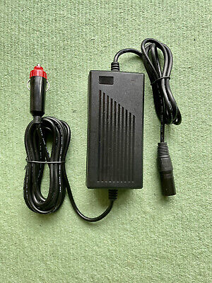

I found some but they are expensive so ddnt bother posting. I found a company selling a folding power chair similar to the one you posted for £700 but can't find it again now :(
Is this worth looking at?
Yes looked at a few like that but getting info is like extracting teeth the one in my OP answered ALL my questions in about two hours is UK based in Harlow, so it is deffo looking like the one, having two batteries but only needing one and a range on each of 12-15 miles wins hands down for us.

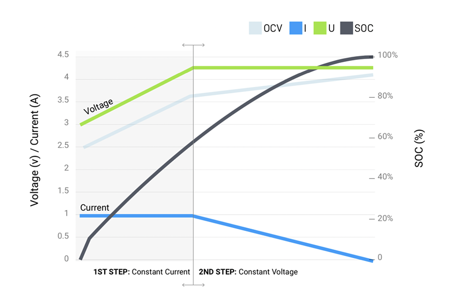

looked at charging times
Useful page if even a thicko can use it :D :D

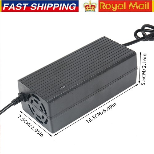

Now before I go and buy the car 24v charger is there any good reason not to do so please.
not just going to stick with an 240V and use the inverter?
I like the option of a back up and charging from either or even both David, just checking to make sure it was okay to do so.
fair enough - and with the second charger and two batteries you can supercharge the process :)
