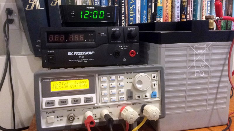

This article is an excellent read re how fast batteries charge versus current over time
