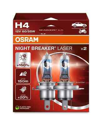

I think any improvement will be over what you have fitted now. If you have something like Osram Nightbreaker or the Halfords equivalent you will have the best that halogen can give at a modest cost. If you have standard Halogen lamps you might try upgrading before changing to LED's ?

Thanks for all the information, looks like the nightbreaker solution a good option, and staying legal
And definitively no canbus issues ;) but DO take a look at the Halfords alternative as they come with a great no-questions-asked-guarantee which might be useful.
