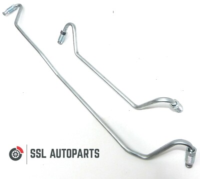

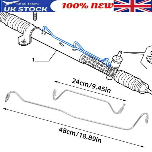

If the ones in the link are correct they're just brake pipes anyway so any back street garage should be able to know them up.
Hard to tell from the pics GG I was going of the end fittings but could be of course.
The pipes on my rack (2005 Ducato) were definitely not 12mm. The hydraulic shop swapped the fittings and swaged the ends.
