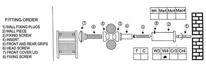

This may give you a better idea, you want to remove item 7 which will have a ring/swage on the male part the piece fitted to the wall 5 will have a groove so when inserted they snap together. Screenshot_20210513-104656_Chrome.jpg
Thanks for diagram.
#7 just does not want to part from the fitting. What I don't see on the diagram, and I can't work out exactly what purpose it has is the ring that is between the cap and the main outer 'shaft'. It just turns with no resistance.

The ring is the retainer to keep the cap in place. The diagram is for a radiator bracket which is similar to the towel rail.

While it kind of looked like the diagram posted, it was actually very different. There are 5 parts to the towel rail rod support.
1 of which (not shown) is a plate that fixes to the door (or a wall); the other 4 are in the photo below.
The long bolt with the screwhead goes into the larger round plate (middle right), right through the post and tightens on the end cap (top middle).
This bit is shown below
The problem was the bolt was loose allowing the post to wobble around. Turning the end cap made no difference as it just meant you were turning the entire bolt - and there was nothing to stop the bolt head turning as well so could have turned for ever and it would not have freed it further - and pulling the cap just meant you were trying to pull the head through the small entry hole, which is not going to happen either.
When I was looking closer at the fitting with a torch, I spotted a tiny flat-head screw at the bottom of the larger round fitting - you can see it on the left of thre picture above. Undoing this released it from the door/wall fixing plate, allowing the whole set above to be freed and the screw tightened :D
