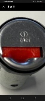

I'm sure lots of people have managed like me to misplace their motorhome keys.
My mh is locked on my drive, so keys must be at home, but after 3 days searching they have not turned up.
As far as the ignition keys are concerned I have a duplicate master key, but here is the real problem...... attached to my lost ignition key are the keys to the toilet cassette locker and the key to the water filler cap.
my question is how do I solve the problem?
View attachment 77201View attachment 77202

Ref the keys, as suggested, ZADI and Vecam and SDS are all the same fitment and one of these brands will be used on probably 99% of all European/UK Motorhomes. It is very easy and inexpensive to get a full replacement set of barrels to cover all the locks. They'll come with 2 or maybe 3 key, so you have your spare there. Don't usually have the removal/refit key which would need to buy seperately. This key is typically RED and only works with an unlocked barrel (otherwise it would be rather an unsafe system, would it not).
